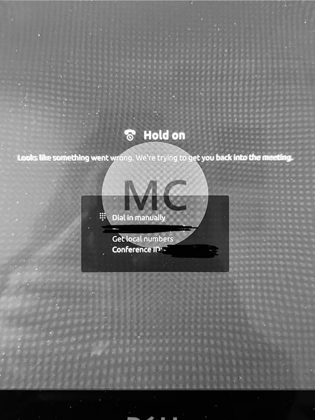

Internet connection is really bad. I can rarely stay on a teams meeting without it glitching or dropping
I have a pod in the room next to my study because the WiFi signal couldn’t reach the other side of the flat. Up until a month ago the internet was fine but as of lately I am unable to do my work properly. Websites load very slowly. When I’m on a teams call with at least one or more than one person having their camera on the call is lagging/glitching/dropping. Even when in screen sharing it lags. Colleagues have started raising complaints about my internet situation and my manager already asked me if I can change providers. I did a samknows speed test during one of these glitches and I got 0.62 mbps download speed. Even if I’m in the room with the pod sometimes the videos do not load and have to use data instead. The condition of the pod on the VM Connect is always Fair or bad but it never improves to good.
12 Replies
  • I’m not sure how I can do that when the internet drops and it becomes unusable. Only today I was in three meetings. All of them lagged and eventually I got dropped out of the meeting due to connection issues. I tried to go on the rapid test website while that was happening and it couldn’t load the page and eventually timing out.
