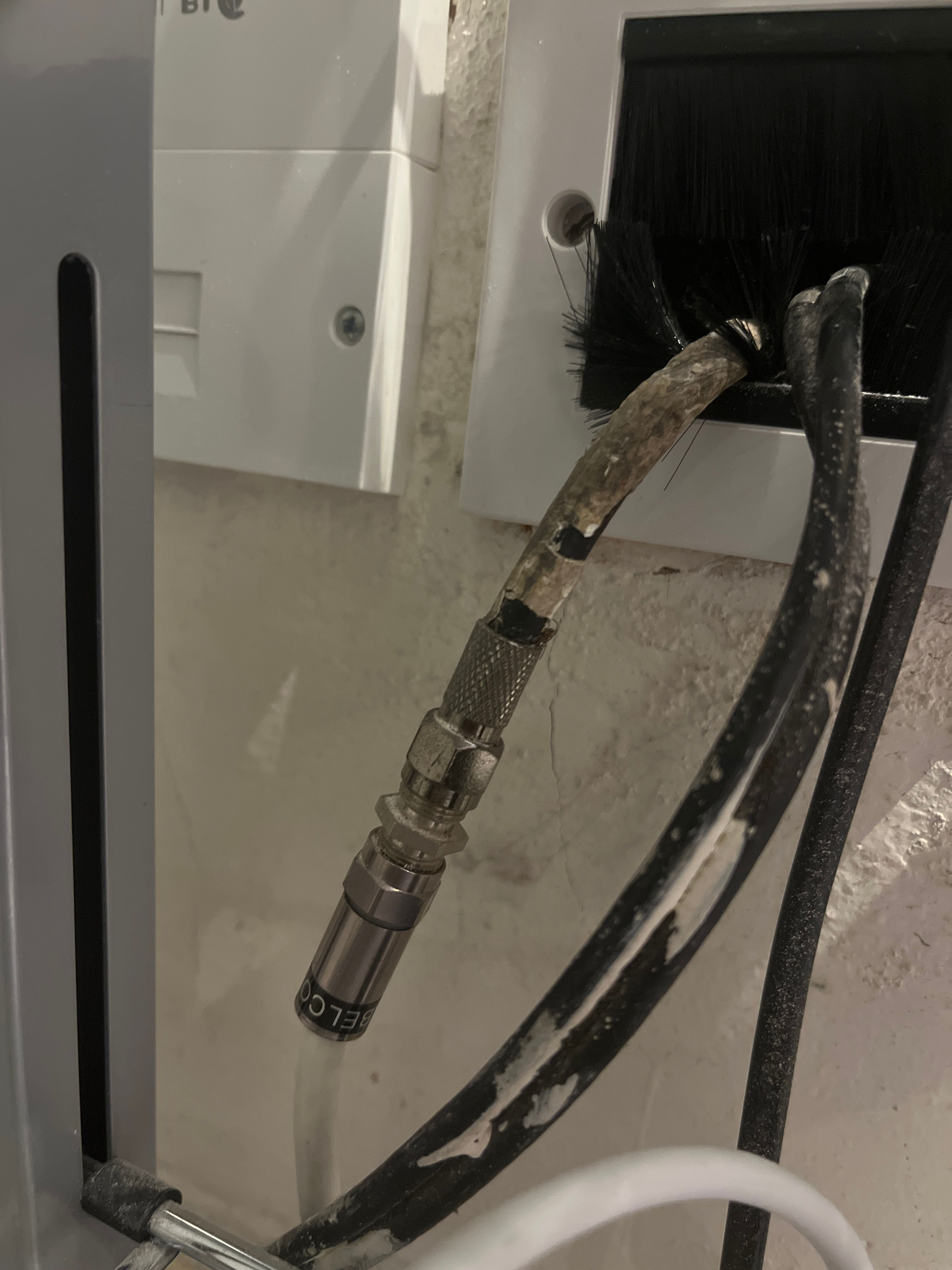

Hi! My broadband died today out of nowhere and is no longer reconnecting. I’ve followed all VM instructions to reset the router and retry cables with no success. On the Hub 3.0 status overview, Wireless is on, but it says Internet (Access denied) and the two green arrows are flashing green. We’ve not changed any settings or usage recently, so not sure why this happened!
Based in North west London.
Any help or advice welcome! Cheers

  • The primary issue  has been found - I found this cable, which is where the line enters the house before going into the VM white plastic socket. At the top of the metal part, the adhesive/material has failed and the cable had become loose. I have now pushed the cable back into the metal part; however, I’m not sure how safe/secure this is and whether it will need to be replaced. I have an appointment booked for a visit but I’m not sure if this is a valid maintenance call out or not. Would appreciate if someone could let me know!

    That looks like someone has used a DIY twist-fit F-connector to make the connection. VM uses a crimp connector which avoids the issue you are describing.
    You need a VM tech visit to make a proper repair.
    One of the VM forum team should be able to book that when they reply here, usually within a few days.
