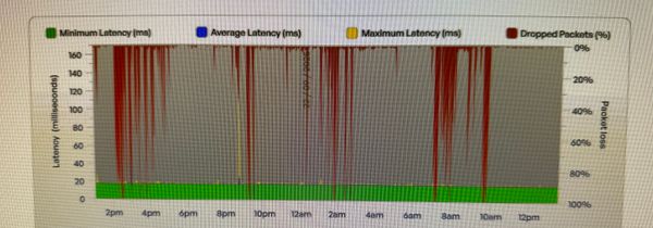

Intermittent Signal in my area
Hi, did this ever get sorted fully for you?  Im in the DH9 postcode as well and had the 2gig package installed in July.  started having frequent drop outs a week or so ago and seems to be daily..  today is an nightmare.

    The BQM doesn't look too good. It's possibly dirt on the optical cable.

  • Hi, was showing intermittent signal in the area.  I have an engineer booked now for tomorrow however I have now completed a factory reset of the 5x and it seems to have stabilised since.

        All good. Router swapped out.  Seems to be good so far.
