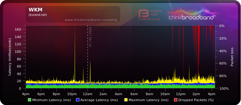

To help troubleshoot the problem, I’ve set up a  session on the laptop and in the house network pinging one of VM’s DNS server (194.168.4.100) every 10 seconds. This alerts me when things start to get flakey. I’ve also set up a ThinkBroadband Monitor to keep an eye out the connexion from the other side.
There have been several outages today including one just around lunchtime. Just after this occurred, I phoned up VM support and eventually got through to a a rep who did some test and said that its all working ok. Of course, by the time I’d got through to support and he’d started his test, It had indeed started working again. That’s the nature of intermittent faults. He said he could do nothing to help and that I should phone back when it happens again.

Here is a snapshot of today’s ThinkBroadband monitor:

  • After a week of relatively functional service from my broadband connexion, it's all gone down hill today. At 10:53, the connexion dropped, and it has been chopping in and out ever since. See the attached BQM graph
    Maybe there are engineers doing something in the area?
