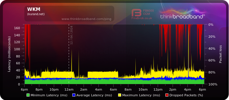

Here is a snapshot of today’s ThinkBroadband monitor:
