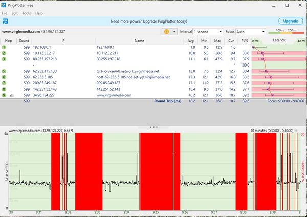

Hi,
I've been having horrendous trouble with my broadband connection since easter. I've been monitoring it with PingPlotter pinging www.virginmedia.comand can see the 100% packet loss spiking over the course of a few minutes to complete loss for minutes on end. Then I'll get periods of hours with no trouble. I work from home and frequently have interrupted Teams meetings where I have to apologise for missing minutes on end when my connection starts misbehaving. And forget trying to play online games. Please note, my computers are on LAN connections NOT WIFI ( WIFI seems to be all the phone support want to discuss ).
I can understand the intermittent nature may make it hard to fault find on, but I've now had multiple engineer visits. My Hub5 has been swapped out, ALL the cabling in my house has been replaced, the splitter has been changed, they've even put in new cable from the house to the street junction box ( which left me without a phone line for 2 weeks but that's resolved now ). I've tried putting the Hub5 in modem mode and using a TP-Link router but it made no difference. There were engineers out today working on the street hardware but still my network is unreliable.
I've been with Virgin Media for more than 10 years and this is the first time I've seriously looked at leaving. I think this forum is my last hope before I up sticks and move. Please could someone help put an end to this.
This is a typical period of instability captured on PingPlotter.

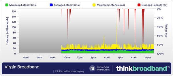

And here's one from ThinkBroadband
Thinkbroadband.com share
