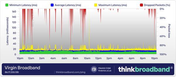

Intermittent dropouts for past 2 months
Hi,
I've been having horrendous trouble with my broadband connection since easter. I've been monitoring it with PingPlotter pinging www.virginmedia.comand can see the 100% packet loss spiking over the course of a few minutes to complete loss for minutes on end. Then I'll get periods of hours with no trouble. I work from home and frequently have interrupted Teams meetings where I have to apologise for missing minutes on end when my connection starts misbehaving. And forget trying to play online games. Please note, my computers are on LAN connections NOT WIFI ( WIFI seems to be all the phone support want to discuss ).
I can understand the intermittent nature may make it hard to fault find on, but I've now had multiple engineer visits. My Hub5 has been swapped out, ALL the cabling in my house has been replaced, the splitter has been changed, they've even put in new cable from the house to the street junction box ( which left me without a phone line for 2 weeks but that's resolved now ). I've tried putting the Hub5 in modem mode and using a TP-Link router but it made no difference. There were engineers out today working on the street hardware but still my network is unreliable.
I've been with Virgin Media for more than 10 years and this is the first time I've seriously looked at leaving. I think this forum is my last hope before I up sticks and move. Please could someone help put an end to this.
This is a typical period of instability captured on PingPlotter.
And here's one from ThinkBroadband
Thinkbroadband.com share
It seems the done thing is to include router logs so here goes.

    Staring off the page are the many Post RS Errors and Uncorrectable errors (Active Profile)
    These need to be resolved on your line or in your street.

    The metrics are on the Hub power levels.  If, after a Hub reboot, the PostRS errors and/or T3 timeouts continue to rise in numbers, there is a fault.  Where that fault lies is up to VM to find and fix.  Changing a Wifi band from 2.4Gz to 5Ghz or vice versa will make no difference to the line statistics.
  • Still no nearer getting this resolved and had no response from Virgin Media for over a week. I don't know if it is significant, but I'm seeing quite a few MDD message timeout errors in the router log. Could be it's just a reflection of the 100% packet loss as seen on this BQM snapshot, but maybe means more to someone in the know?
  • Roger_Gooner's avatar
    Roger_Gooner
    Post RS Errors on all 32 downstream DOCSIS 3.0 channels indicate poor downstream signals which in turn means that your hub is failing to receive MDD messages from the CMTS. If all cabling, splitter and hub 5 are in good order, then VM needs to investigate further, e.g. noise ingress from a property connected to the same distribution cabinet (happens more often than you'd think), fault inside a cabinet.
