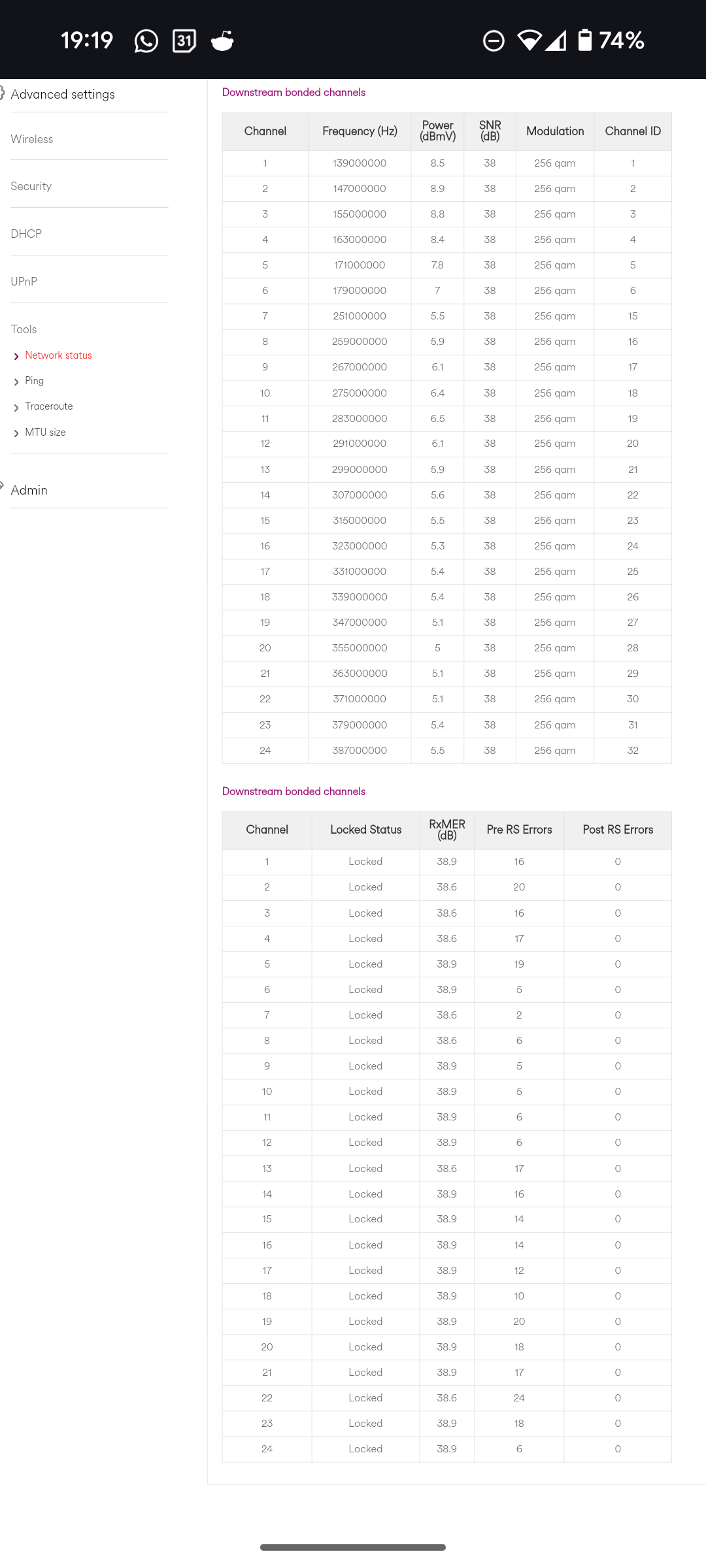

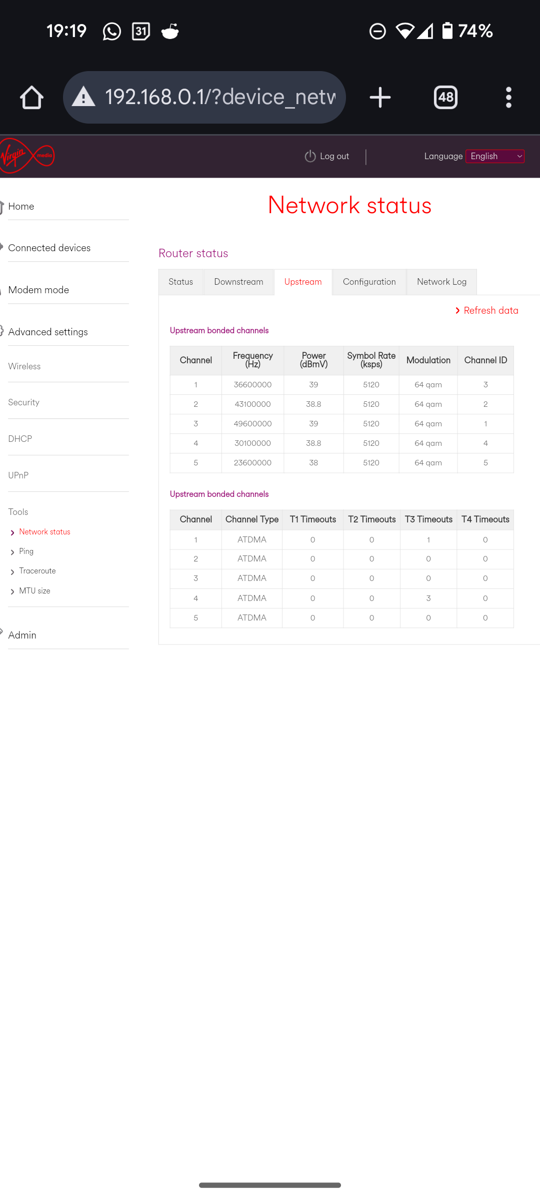

Will an engineer help? Network stats are in following posts:
