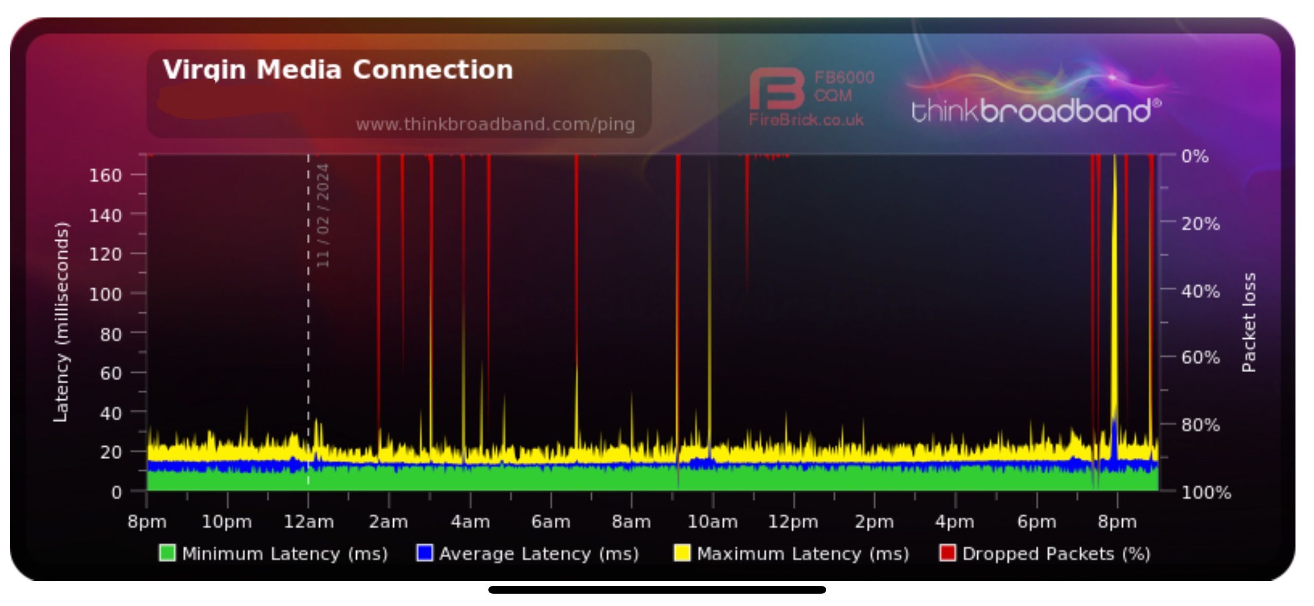

      I’ve been told a dissatisfaction case has been raised over 2 weeks ago. However, I have not been contacted, nor anything shows on account in My cases (not sure if thats exact name), I have been reaching out every day asking to speak to a manager or supervisor who could help me resolve this. Just to be told that they will contact me ‘that day’. Again heard nothing back. Last contact today I was told they work until 10 PM and leave the escalations call until the end of the day as they take the most time??? Cant believe this.
      They have advised an engineer will be out later this week to ‘fix’ the issue. I’ve been told this for the last 13 month! That’s why I want to speak with a manager or supervisor.
      Screenshot of my connection from yesterday (12 times there was loss of connection?)
