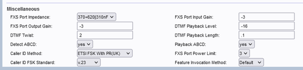

    VoIP echo can be affected by SPA112 >> Voice >> Regional settings.
    This is from our SPA112, we are not having echo issues.

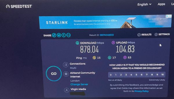

    explained I suspect my browser wasn't speed testing correctly, and that I'd run a test from another PC on a seperate VLAN only this morning. Was seeing close to paid-for speeds, so I was pretty happy its all working as it should.
    ....as you see, 878Mbps with a listed max400Mbps firewall. This has been my experience with my last 3 Drayteks, getting way over the listed max throughputs.
