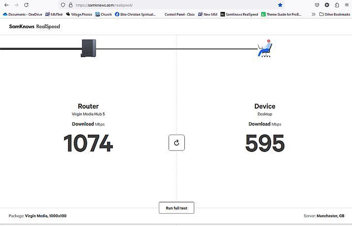

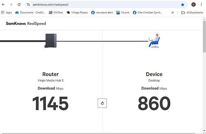

    I'm on Gig1 with the hub 5 and have my PC connected via ethernet cable to port 4 (labelled 2.5GBps) I actually bought a Wifi6 ethernet adapter from Amazon as my PC's network card was only Wifi5 Gig1 and I wanted to get higher speeds.  Without my adapter I was normally getting around 780

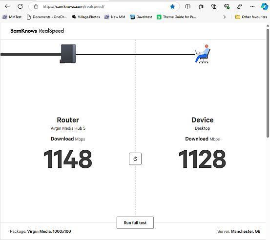

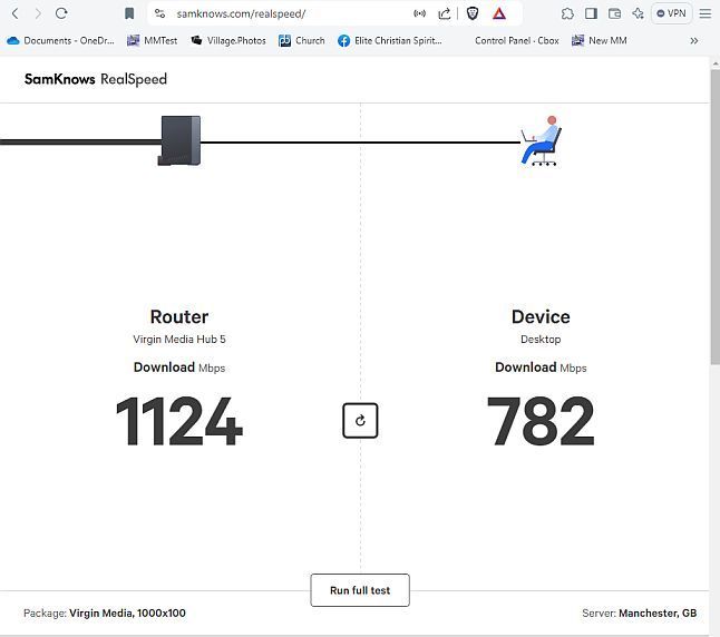

    I can see different results running the samknows speed tests through different browsers on my desktop computer.
    In fact I can run 3 speed tests on the same browser, one adfter another, and the speeds can vary by around 100/150 Mbps.
    I find measuring using Edge seems to show higher speeds than the other browers.

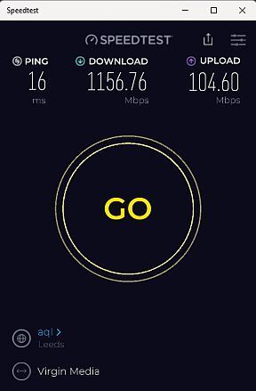

    I've also noticed that the Windows Ookla app always gives me a higher speed than measuring using ookla's speedtest.net via a browser. Screenshots below.
    bravechromeedgefirefoxookla app

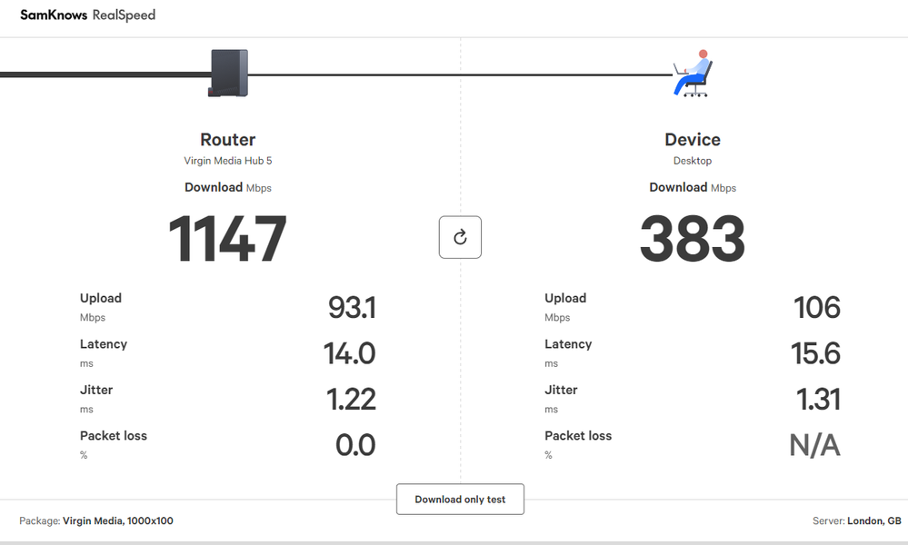

    Do share a screen shot of the Full Test for discussion.
    • innesuk's avatar
      innesuk

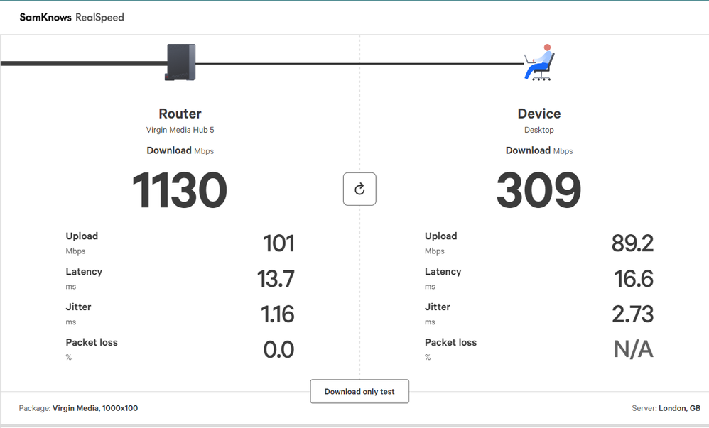

      I believe its a Hub5x. Virgin sent me a new one. I was on Just Hub5.
      I've ran the full test and the Hub side of things says it's getting the full 1gbs but the download is reporting 240mbs which is at odds with the 750 I'm getting with speedtest.net. I ran the tests several times.

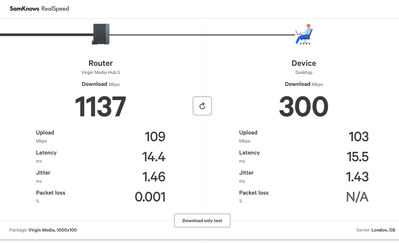

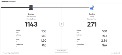

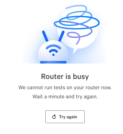

        Here are the results with WiFi switched off and only the computer plugged into the Router with a Cat7 cable.
        Pretty much the same results. A couple of times it came up with a router error. Maybe I had upset with so many modem speed test. I refreshed the page and it worked.
    If your Desktop PC maxes out at 739 Mb/s that is hardly going to make it lag during your next Tesco order !

    Your Hub 5 is getting the full speeds down and up that you are paying for.
    How you use those speeds on your side of the Hub is your own problem - particularly over WiFi to your phone.
    There are many speed tests available
    It is quite unclear if any are correct, as none of the results match.
    We don't need to see any more speed tests as there does not appear to be an issue to solve.
