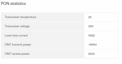

      Hey,
      Any chnace you could share your Network Status values... pls
      I'm having trouble with mine and would like to know if the values are within the required limits.

        Hello Chaddy_v6
        Thanks for raising the questions in regards to your services and Hub5x.
        These aren't details we have access to but have reached out to the team who support with these Hubs for assistance and to check if the values provided are what they would expect to see. Is there a reason you are checking these?
