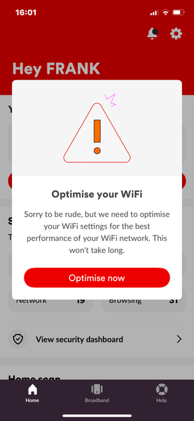

Hub5 smart mode
Hub5 insists on smart mode. I need 2.4g WiFi for old devices (ring 2chimer) which will not work in smart mode. All the app will not let me manage network when using two WiFi frequencies . I have to use pc to change anything. This is very frustrating. Had been using hub3 in modem mode and a netgear router and that worked fine  using 2.4 and 5ghz frequencies. Not impressed.

      The Connect app is totally forbidden in our home.
      If it is installed without warning the following happens to our VM Hub :
      1) Smart Wi-Fi aka Wireless Channel Optimisation is Re-Enabled.
      2) Auto Wi-Fi channels are Re-Enabled
      3) Guest Wi-Fi is Re-Enabled
      4) Reserved IPs for a Printer & VoIP phones are Deleted.
      Do the setup by hand in the Hub admin menu and retain control.
