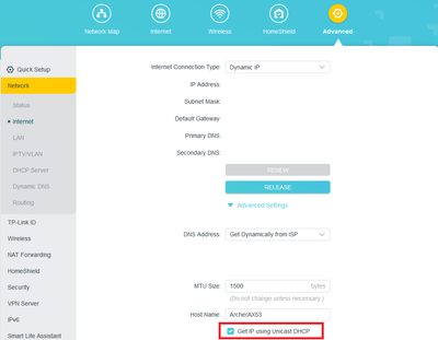

I have already raised this with tech support while they stated that modem mode is unsupported, they sent the following (see screenshot):
I've read in previous threads that you do have to configure modem mode again if your WAN IP changes. Is that what's happening? Is there any way to prevent this?
  • Thanks for the helpful advice, legacy1
    I was able to narrow it down and enabled "Get IP using Unicast DHCP" on the TPLink router.
    If anyone else has the issue:
    1. Head to your tplink interface (tplinkwifi.net) and sign in
    2. Head to advanced
    3. Under network, head to Internet
    4. Under Internet, expand Advanced Settings
    5. Tick "Get IP using Unicast DHCP"
