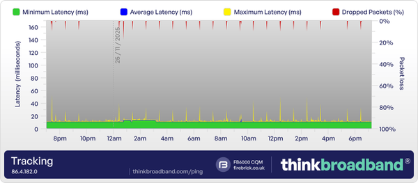

    Proof from my broadband quality monitor - 23rd of September when it was fine:
    Then the 24th September - look how awful that is, its not suprise I was lagging
    This is STILL going today - here's an image from 20/11/2025
    PLEASE STOP THIS. This is unacceptable considering the cost.
    I am already past the 3 month 'testing' period OFCOM supposedly need - why is this even happening again?!

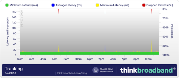

        Interestingly since your response here 5 days ago exactly, an hour after your response I am no longer receiving the regularity of 30min packet loss spikes. I am currently only being disconnected twice/three times a day which is much much better than 48 times.
        02/07/2025 - Day of your response
        03/07/2025 - Day After
        05/07/2025 - Yesterday
        Obviously not perfect but if this was your doing; thankyou :)
