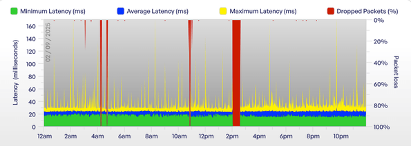

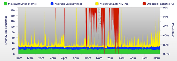

I’ve also monitored performance using ThinkBroadband BQM and observed clear packet loss and latency spikes aligning with the modem errors.

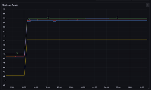

  • Just an update on my situation. Yesterday (2nd September) a subcontractor attended unexpectedly and carried out a repull. This came as a surprise as I had previously been told there was a construction issue requiring permits.
    Unfortunately, the repull hasn’t resolved the fault. My monitoring shows upstream power levels are now in the mid-50s dBmV (previously around 46–47 dBmV). The ThinkBroadband BQM continues to show high latency spikes and packet loss, and the Hub logs are still reporting errors.
    Daniel_Et had previously shared feedback from the Area Field Manager suggesting the drop cable might not be the root cause and my results seem to support that. It looks like there is still an upstream fault further into the network.
    Thanks to everyone here who’s followed along — I’ll continue to post updates.
