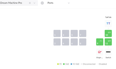

    Pretty much as Tudor has said, I would refrain from using the UDM ports for switching. Here's my current setup:
