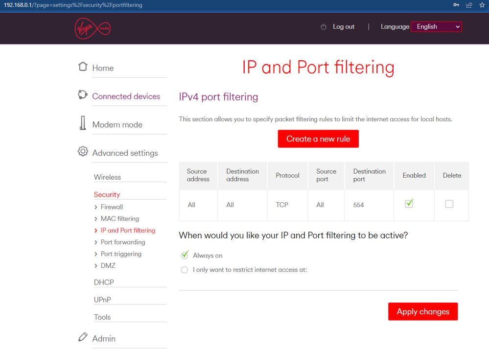

    There are two possible immediate fixes until Virgin deploy a new firmware:
    Block 445 Outbound:
    In your router admin page: Advanced Settings > Security > IP and Port filtering > Create a new rule
    The rule should then be set to:
    Source address: All, Destination address: All, Protocol: TCP, Source port: All, Destination port: 554, Enabled (checked)
    This will simply stop any RTSP streams from being established. In VRChat specifically you will lose world music, but everything else should keep working.

    There will be no proper fix until Virgin's engineers patch and deploy a new firmware version. But there are 2 short-term options:
    Block 445 Outbound:
    This will simply stop any RTSP streams from being established and thankfully it also stops the ALG from trying to "help"
    In VRChat specifically you will lose world music/video in some worlds, but everything else like voice, movement, avatar and world loading should keep working.
