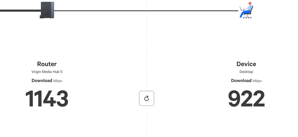

      Hi Beth. Just ran the tests so hopefully you can see the results. I was in the room next to the hub5. I'm not doubting the hub speeds it's the issue getting the WiFi around the house. Unless you are stood next to the hub the speed is terrible. My son was trying to do homework online yesterday and couldn't. I ran a speed test on his PC and he was getting 0.79mb

    Keep the router Hub5 in Router mode. Disable the wifi on the Hub 5, connect the Hub 5 to the Tenda via the GB port, then Tenda should then connect and should work. Im using this method after experiencing exactly the same and didn't want to go down the pod route as they only want to send one at a time.   The below is the wifi from my tenda onto my Chromebook and working perfectly since to did this.
