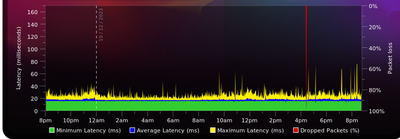

    The VM support technician said there was a fault in the local area.  That may be, but I explained I'd not seen any WAN today issues and reminded the technician my issue is wifi based. Furthermore, the ethernet connected devices were not affected when the wifi dropped out today.  He tested my line (which coincides with the red line on the BQM) and said there were issues which needed monitoring:

    BQM is fine its wifi which VM don't support because not all hub have good wifi and VM will not replace the hub because of it.
