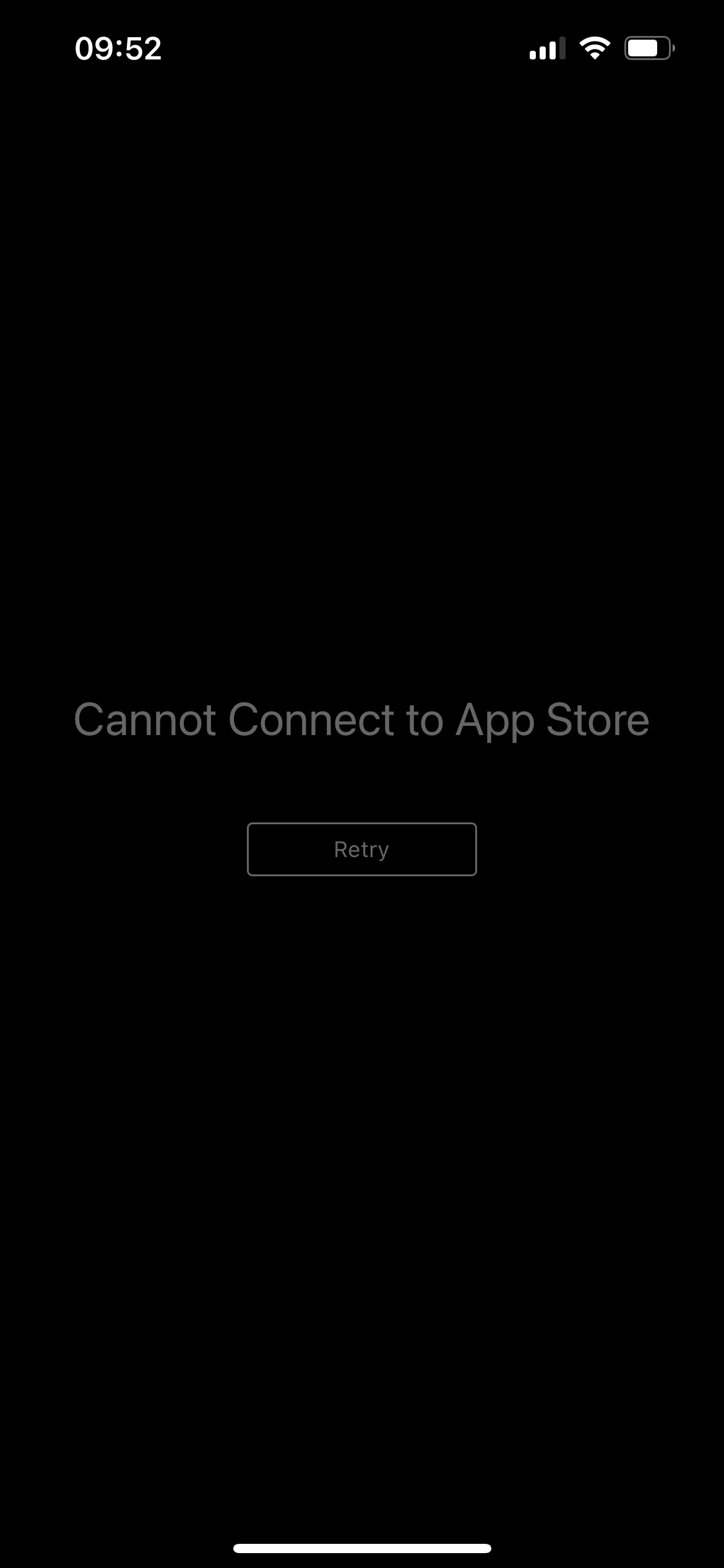

    Thanks for the suggestions, got the app, no devices are paused. Still getting drops, in data processing. Speed is fine when it works.

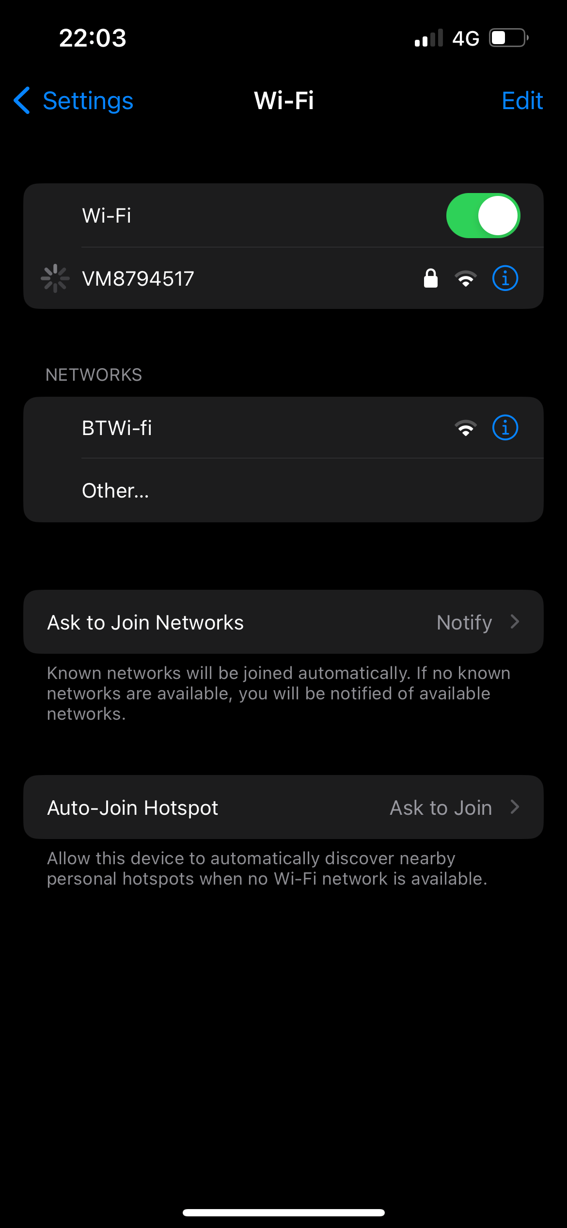

    Photo to prove I have full Wi-Fi signal but yet no connection. I came off Wi-Fi to download the app, then back on and it works fine, until the next loss.

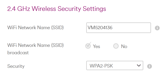

        At the moment it appears to be all mobile phones, we don’t tend to use the iPad and laptop (but old and slow anyway)  2 pcs are hardwired and have no problem. 1 phone is android, 1 iPhone is an 11, latest ios, and another is iPhone 13, latest ios. The iPhone 13 was only purchased 2 weeks ago. I have reset net work settings on both just in case. Router has also been reset whilst on phone to VM support and I’ve also done this myself twice. Issue only started happening about 6 weeks ago now. Nothing has changed in house, router hasn’t been moved, no additional set ups or random electronic items near router etc all as normal.
    We have a Hub 3 in Router mode these are our Wi-Fi settings...
