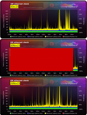

    • Albie1's avatar
      Albie1
      also, not sure if it helps or not, but here are my BQM graphs for 3 of the recent days with Critical messages in the Network Log [26Nov, 30Nov, 3Dec] - not sure what happened on the 30Nov

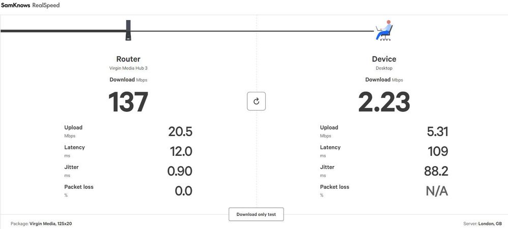

  • Sure - Thanks David.
    Attached (hopefully) are 2 speed reports both run with 5 mins of each other and sitting at the same desk in my bedroom (1 floor up and 1 room along from the Hub3).
    However I am a little confused as the Virgin connect app shows 137Mbps coming to the router (good) and only 15Mbps coming to my phone.
    The laptop wifi shows the same speed to the router but only 2.23 Mbps coming to it. !
    I can see that both speed tests are actually from the Samknows website, so they should be very consistent but one is 8x slower than the other and to be honest it feels like it is running at 2 Mbps, not 15 Mbps at the moment., let alone 130 Mbps. Previously I have talktalk 60Mbps and that was always 20-30Mbps minimum from the same room.
    Any suggestions ?
    Thanks

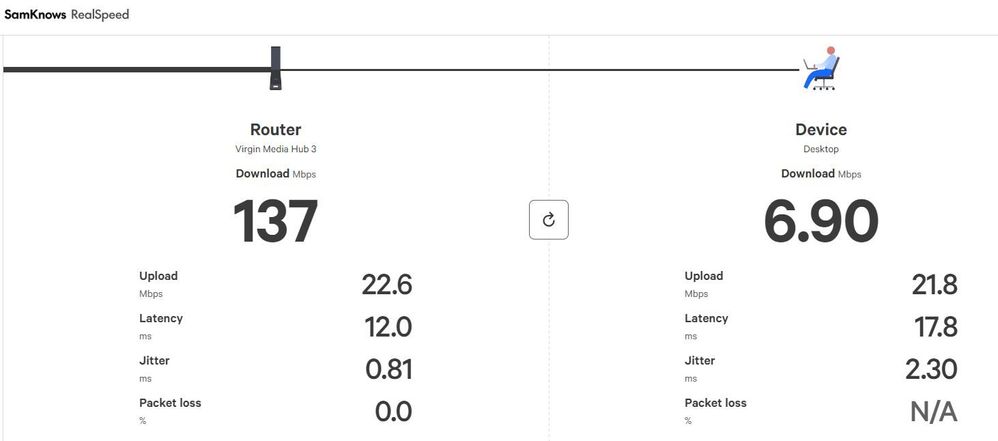

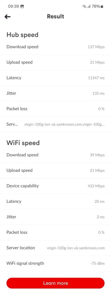

  • HI Alex & sorry for the late reply - I missed you message
    OK I rebooted the router with the switch but after 10mins it wasn't connecting to anything and ran the diagnostics where the following message came up about connectivity issues.
    I rebooted again with a full power unplugged and 2 min pause before powering up again. When it finally connected, the Virgin App on my phone running samknows registered 39Mbps but my laptop ran the same speedtest before and after the phone and got 5.66 Mbps and 6.9Mbps - see attached.
    I'm not technical enough to know what the problem is but as I work from home my TEAMS calls are constantly failing both with the company VPN and without VPN on my personal laptop.
    Any assisting would be gratefully received
    Albie
