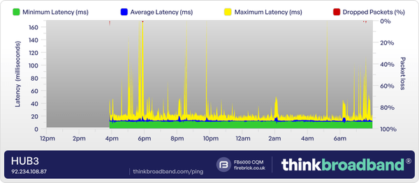

Hub 3.0 overheating llight (RED) go red after few seconds after rebooting
Hi,
We started to have few issues with our network and I am coming to conclusion its the HUB 3.0 overheating as the LED reports RED all the time and when rebooted it goes purple for few seconds and then red again , while the speed stay constant for over 300Megabits, we get quiet ofted what appers to be dropout in network where everything feezes and then comes back again this is happening both via wifi and wired network, sometimes even I get notification on my work laptop that status of my network has changed.

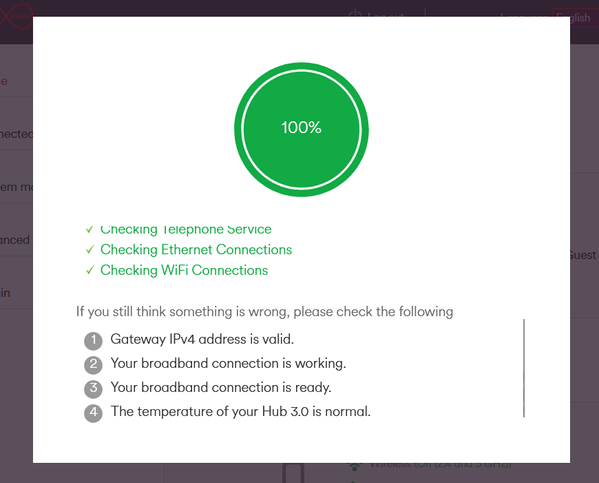

I've tried to run diagnostics on the HUB 3 but with the FW changes now you can't monitor temperature on it, the the diagnostics recomends checking temperature it dosn't report it anymore. The casing of the hub is warm to touch but that dosn't directly indicate its overheating

I just started network mnonitor
<a title="Broadband Ping" href="https://www.thinkbroadband.com/broadband/monitoring/quality/share/b26ce463c31e865108bfc94f3e5ed84b1757f49f">My Broadband Ping</a>

  • There is quiet few spikes going above chart for latency and few poacket loss drops.

  • Hi John, sorry for late replay, the router is in normal mode for the last 5 days, it continues to flacuate with large pings and experaince two very large delay on teams call were internet froze for good 40-45 seconds.

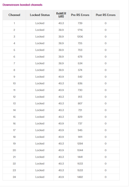

    Generally the brodband in my area is quiet good, since engineers replaced the amplifier board in my local on street box from coaxial to fiber about 4 years ago. As last one was intermitted from the area of NTL and had frequent and produced over 1M pre RS and post RS errors and experianced  SYNC Timing Synchronization failure, thios dose not feel as the same issue.
    24/10/2025
    https://www.thinkbroadband.com/broadband/monitoring/quality/share/62e316b7686415ee9dd33321d2b7b47948b54f8a-24-10-2025
    [url=https://www.thinkbroadband.com/broadband/monitoring/quality/share/62e316b7686415ee9dd33321d2b7b47948b54f8a-24-10-2025]My Broadband Ping[/url]
    <a title="Broadband Ping" href="https://www.thinkbroadband.com/broadband/monitoring/quality/share/62e316b7686415ee9dd33321d2b7b47948b54f8a-24-10-2025"><img alt="My Broadband Ping - HUB3" src="https://www.thinkbroadband.com/broadband/monitoring/quality/share/62e316b7686415ee9dd33321d2b7b47948b54f8a-24-10-2025.png" /></a>

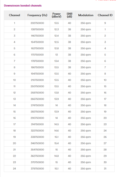

    • cje85's avatar
      cje85
      Wise owl
      The downstream power levels are much too high. They should be under 10dBm but you're getting over 15dBm on some channels.
      A red light is normal in modem mode, the LED fades over time and becomes more red than purple.
    The signal levels could be like this if a 10dB wide band attenuator had been removed from the COAX to the VM Hub.
