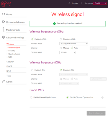

how to disable 5ghz band on a hub5
I need to disable the 5Ghz band to allow set up of my 2.4Ghz smart plug for table lamps. I have logged into the hub but the disable button is greyed out. I have taken this up already with Virgin tech but they could not understand why the disable buttom was like this.
A way to sort this is needed.

  • Hi, if you turn off smart WiFi then you will be able to turn off 5GHz.
    Hope this helps.
