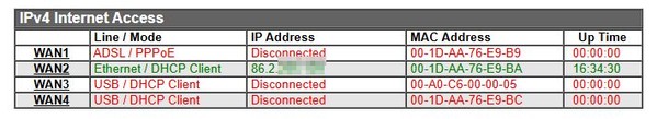

    Just thinking about this, the WAN IP is going to be my router not the hub, so those URL errors will be coming from there not the hub. So how do I find out what IP the hub is on?
    Here's the WAN interface on my router:

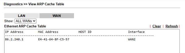

    The only thing in the ARP cache is the VM gateway at the other end:

    Maybe the hub doesn't have an IP address when in modem mode and simply acts as a layer 2 device.
