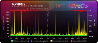

      I've just reactivated my ThinkBroadband tracer on the new network, and am getting an awful lot of dropped packets and high latency

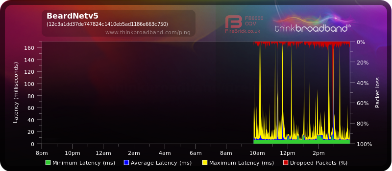

    how is your think boraqdband monitor looking? Also I am spurprised that nobody has checked your modem levels? did your hub 3 have any sort of attenuator on the back between the modem and the actual cable? Are you running any sort of firewall software on your PC? Clear down your browser cache as well. Also I don't know the answer to this one.. the protection settings have not been switched on withoun your account? (Sorry I don't know where these are or the proper name for it something to so with child protection or whatever)
  • beardedian's avatar
    beardedian
    Latest chart
     No attenuator on previous hub, direct replacement using same coax cables.
    Same issue whether Firewall on or disabled, have cleared browser (Firefox/Chrome/Edge) cache
    The issue isn't site specific, BBC, FB, VM, etc
