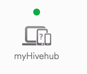

  • Does the hub status show the Hive Hub as being connected?  Have you tried a different ethernet port?Status from VM Hub

  • I have a problem with Virgin Hub 5. It worked fine until virgin carried out some updates remotely. Since then the hive hub just flashes green and wont connect. I have followed advice on these threads and have tried
    1. trying various alternative ethernet cables - made no difference
    2. Buying a cheap 10/100 switch - made no difference
    3. connecting via another router - made no difference
    4. called hive who told me virgin media need to open up a number of ports. I have tried, but they dont respond.
    HELP!!!!!

      Additionally, I have tried running hub in Modem mode - made no difference.
      I have also run the network diagnostic tool on the Hub 5 admin page. With the Hive hub plugged in I get a report of a ethernet device that might be affecting network performance. When I unplug it, and run it again, I get a clean bill of health for all (other) ethernet connected devices.
      There is definitely am issue with either the Hive Hub or the way the Virgin Hub 5 is connecting to it.
