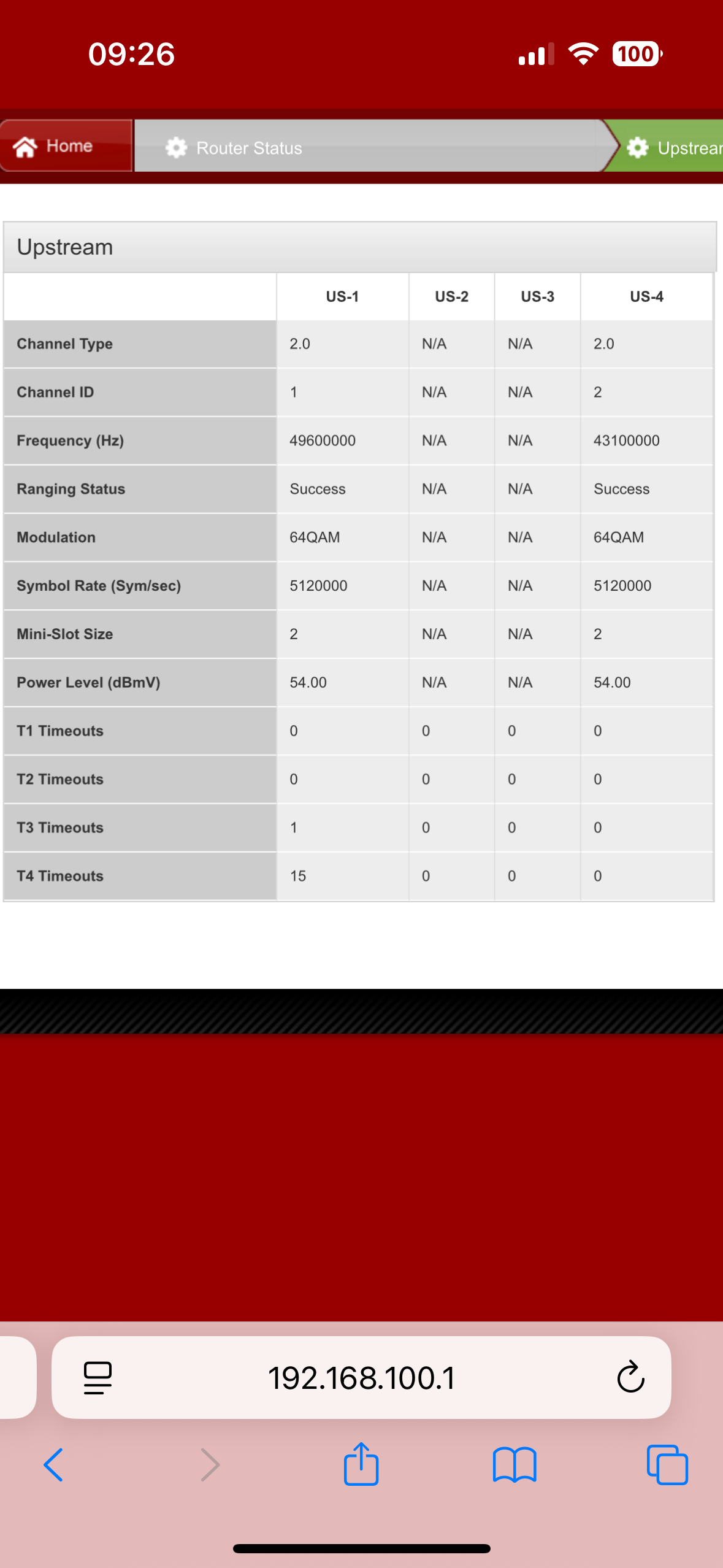

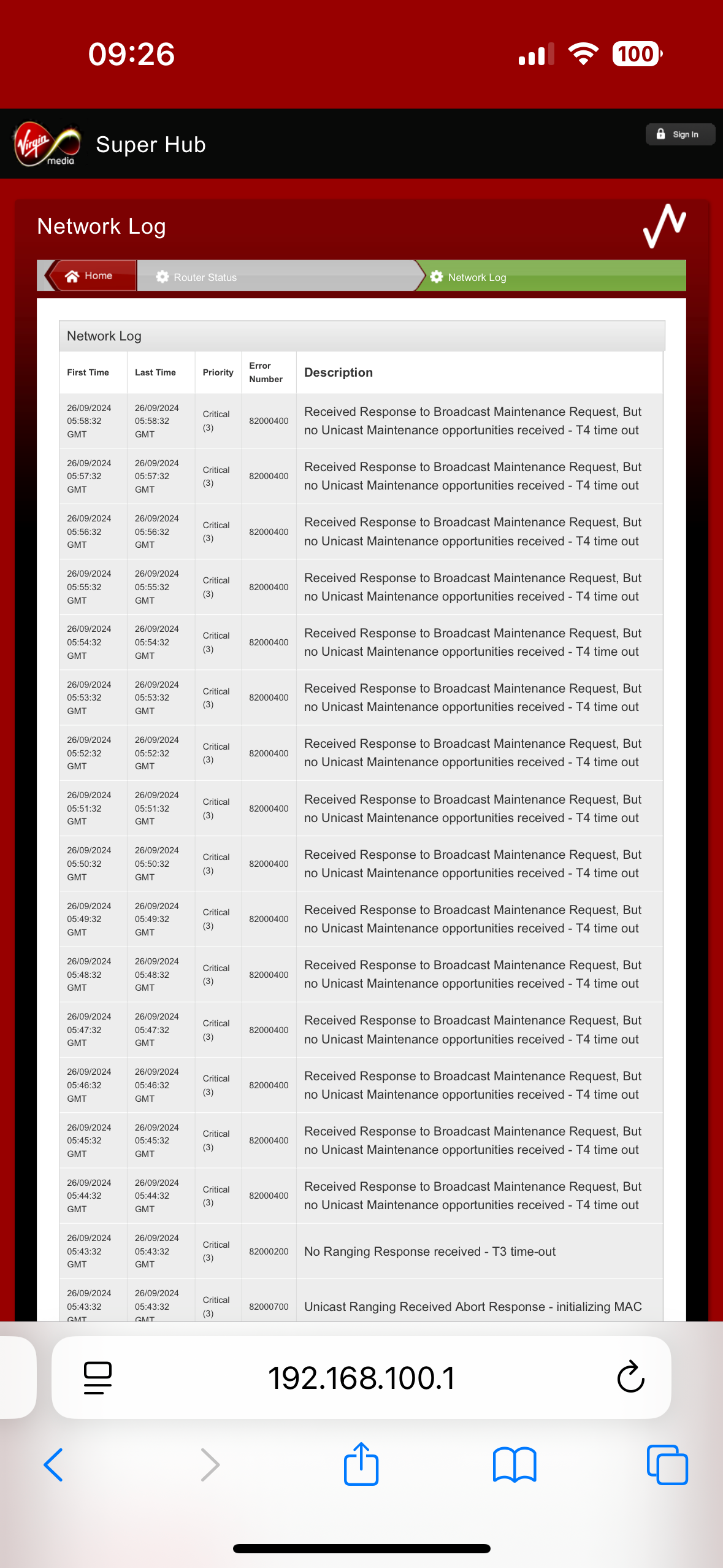

Ive been having a lot of disconnections and rebooting over the last few days, im unsure if the power levels etc are too high are not but they do look slightly out of whack.

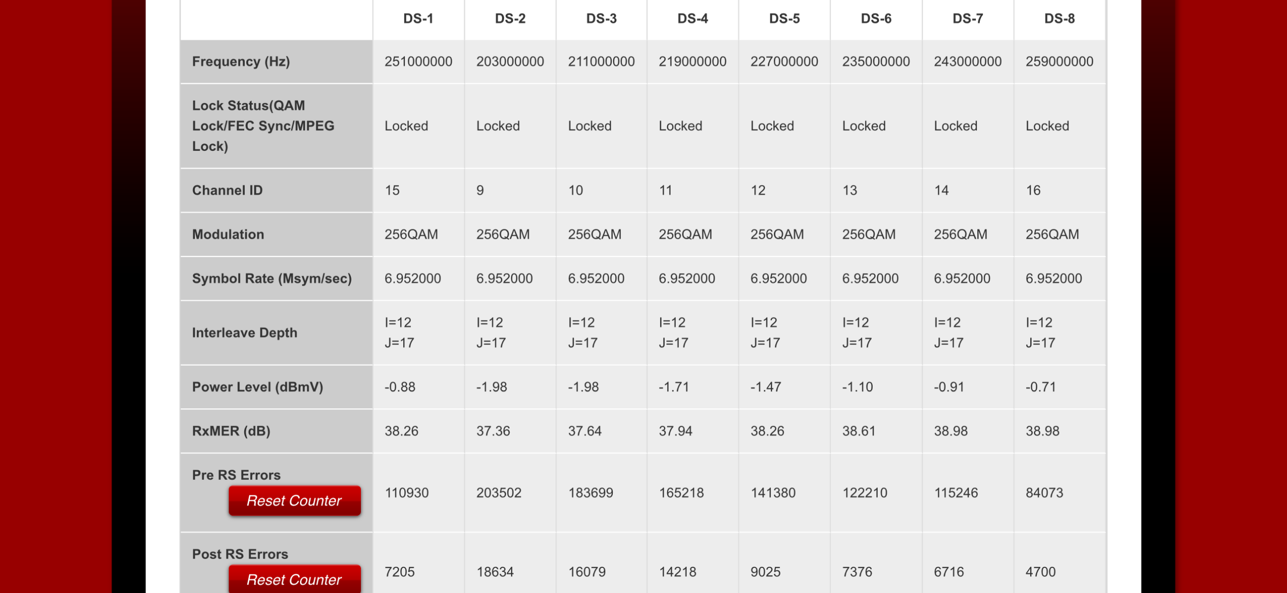

    Downstream Power looks ok but with errors on all channels,
    if those error counts are still rising a local noise problem persists.

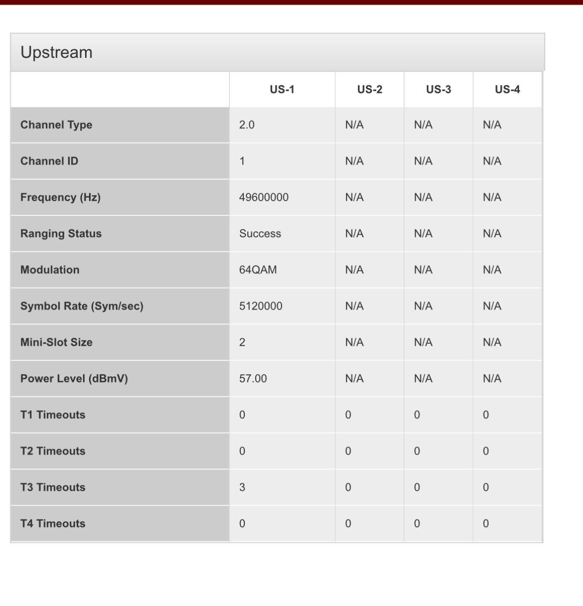

    Upstream Power Level is High ( hub is working hard to send signal to the street cabinet )
    but also there is only 1 Upstream Channel connected when 4 or more are the norm.

    This is an extremely poor connection. If there is no local area fault notified, phone customer service and request a technician visit.

    Client62 has provided the power level analysis and correctly suggested that you check your coax cable(s) for tightness.  The upstream power is totally maxed out (57dBm) and while that's going on, you'll have no useable service.

      I used to have an SH2.  One of its "features" was it always displayed RS errors which would accumulate if I didnt reset the counter regularly.  I was told this was because of the method it used to connect to the VM Network !    However, I had a perfect connection - albeit in modem mode.

    Looking at the stats, the upstream is well up the creek.  There's no doubt the visiting technician will replace the hub.  Now we know it's a SH2, there's no need for you to upgrade your package.  But do make sure that when the technician leaves, the upstream power level is normal - as in below 50dBmv.  There's no settling in period - it either works or it doesn't.  When the hub is replaced, you should see at least 4x upstream channels on 64QAM modulation.  Don't let the technician go until it's all working correctly!
