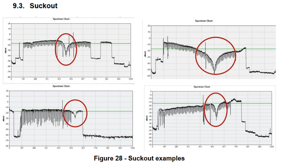

        Suckout examples of various widths and depths from SCTE's "Understanding and Troubleshooting Cable RF Spectrum":
        The same is happening with OP's signal. It drops many dB across a couple of channels.
