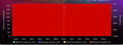

I have been monitoring the performance through a BQM since October and every day looks like the below;

    The all red BQM may not pointing at the Public IP of your VM Hub which is 80,4,28,149

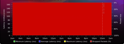

      It shows the router and the device as having 0% package loss. VM backend tests and BQM are showing 100% packet loss.
      Since my original images of BQM and Speedtest got deleted I post them here.

    BQM need you to allow ping reply in the hub settings if it spikes when your not using your connection thats a problem.

      The BQM was set-up a couple of days ago to the router IP (as identified by BQM and confirmed in router settings), it looks exactly the same as when using VM Hub 3.0 (all red, 100% packet loss).

         firewall settings you need to allow WAN to Router ICMP/ping
        note your WAN IP would of changed for BQM so update it
