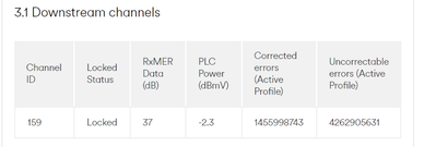

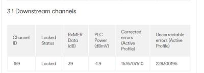

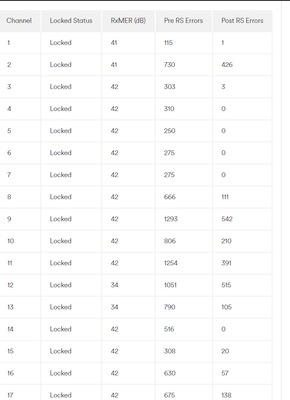

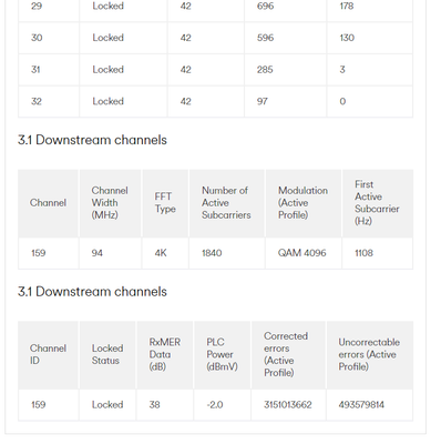

As above, recently got upgraded to a SH5 from a 3 - now I'm having issues every day with it - the connection will randomly drop out on the incoming side once or twice a day, with a lot of post-RS errors (it's often much, much higher than these which are the current ones):
The wifi is terrible too - it'll often drop the 5ghz network completely and everything will drop back to the 2.4ghz network, sometimes everything reconnects, other times nothing will work until I change the channel back and forth on the router and let it all come back up  (even worse, the channel changing bug where it won't change channel unless you also change channel width and then change it back, is STILL there in the software and that's a bug I reported probably 4-5 YEARS ago, come on, really?!)
Didn't have any issues with the SH3 like this, possibly a faulty SH5? Anyone had similar issues?
I'm also getting awful speed drops, even when the errors on the incoming side stop accumulating, I'll have maybe 60mbps download speed, instead of 1000, and nothing will fix it bar power cycling the router.

  • All the fault scanner tells me to do is restart the router every time. Which, to be fair, usually does work. Which is why I'm wondering if it's a faulty hub
    The RxMER(dB) spans from 34 to 42. On one connection that is odd. ( ours are all within 1 dB )
    Perhaps check for a fault in your street via  0800 561 0061 it is an automated service.
