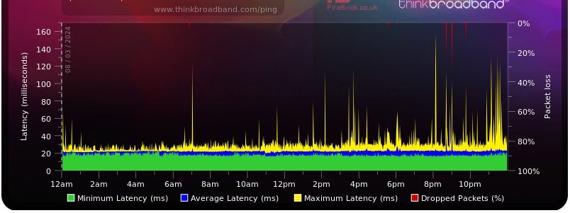

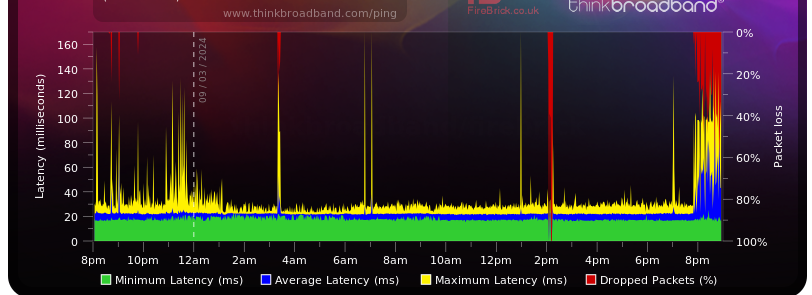

I have been having connection issues for the past few days but today has been extremely bad. Starting at around 8pm.
I had this issue a few weeks back which was posted on the forums in the gaming section which turned out to be my neighbour sharing our cable which resulted in them having to get a repull and their own cable installed which fixed my issues but here we are a few weeks later and the connection is even worse with the connection dropping every few minutes. I have checked the website and called the 0800 fault number and no issues reported in area.
I started a new BQM a few days ago to monitor the connection which has been showing random packet losses but just now its going crazy. Any help would be appreicated. I have already pin hole reset the router yesterday.
09/03/2024 (BQM)
08/03/2024 (BQM)

    yes might be that your 1st hop to VM network shows packet loss meaning the Docsis link is not good
  • jpeg1's avatar
    jpeg1
    That's perfectly possible, yes. Cable faults are a common cause of noise ingress. You need to check your internal connections, but if they are secure you are going to need a technician visit to check to external installation
  • Thanks for the comments. I just called back up and they have booked an "Specialist Tech" to come on Monday. I could hardly understand them and they could hardly understand me so yeah no doubt tech will be clueless when they turn up
  • jpeg1's avatar
    jpeg1
    Make sure you show them the downstream error data, just in case they don't think to check it.
