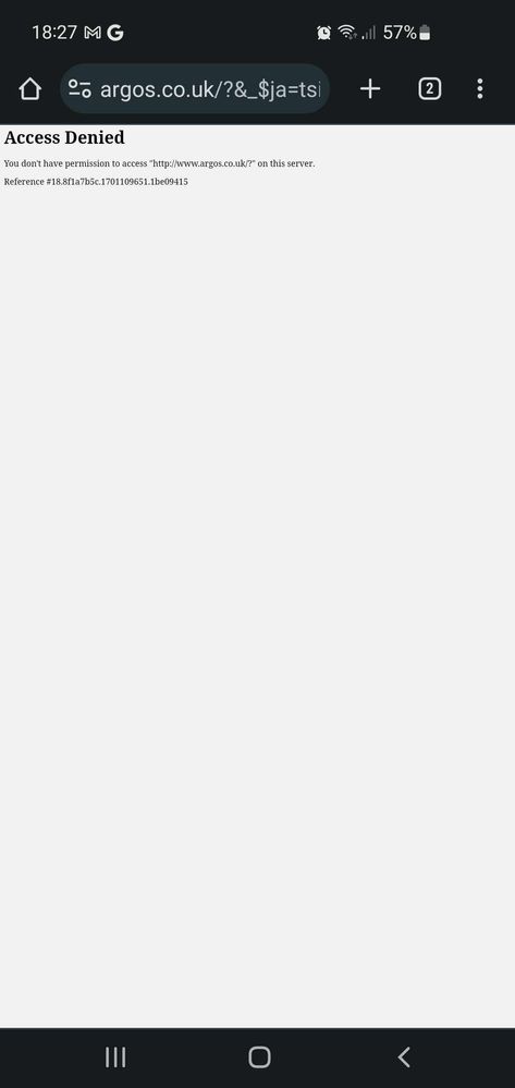

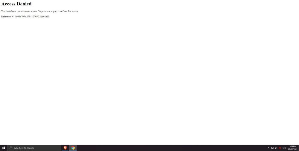

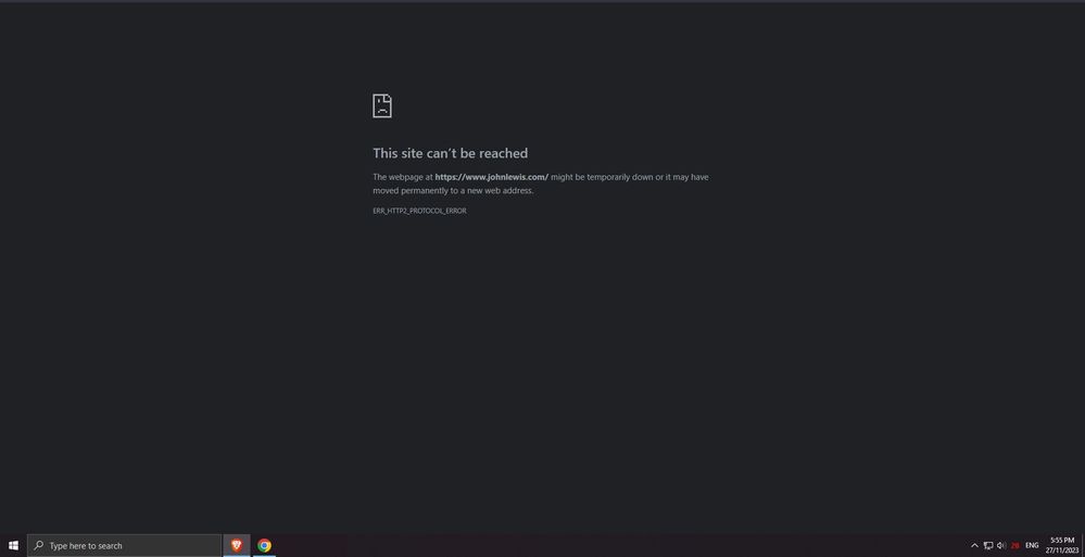

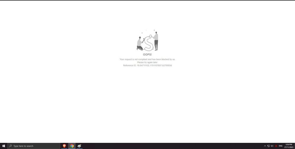

only recently noticed this but can no longer connect to argos  johnlewis or shein on wifi or ethernet connection on the superhub 3 no idea what is going on other sites like currys amazon all work fine but argos jonh lewis shein i can't get on to even on phone or tablet unless on a vpn or using mobile data which is ridiclious  i tried every browser 2 different pc's and a  tablet aswell as phones if connected on wifi same thing
14 Replies
    Sharing screen shots of the error messages for all websites that fail would be a big help

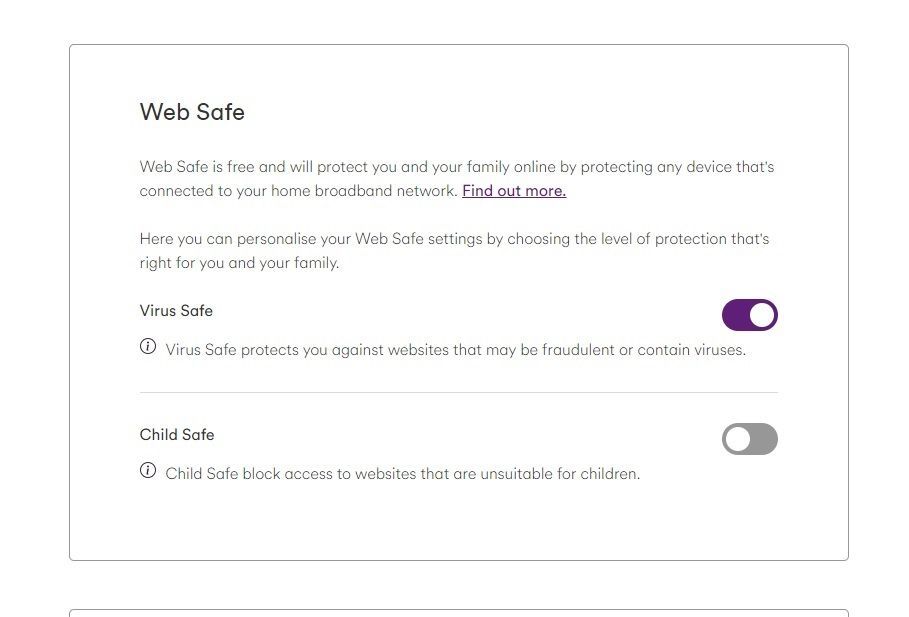

  • The only logic (such that it is) that I can think of here is that the three sites have been individually added to the VM Child Safe parental controls on your VM account. Quite why I have no idea.

  • hey thanks for all the reply's no it's just the superhub 3 itself from ethernet to my pc and i have already tried the obvious resetting the superhub 15 seconds and even turned it off for  2 hours  and sure i will add screen shots now
  • hmmmm the thing is it don't explain why my android devices have the same issue if connecting to wifi on the superhub  but if  i use mobile data i can access sites just fine i switch to wifi refresh page instantly can not access again same goes for pc it i turn on vpn i can get on those sites  shouldn't have to do that for these sites they should work fine without but something messed up with virgin or my superhub like you would think factory reset would fix it but nope
