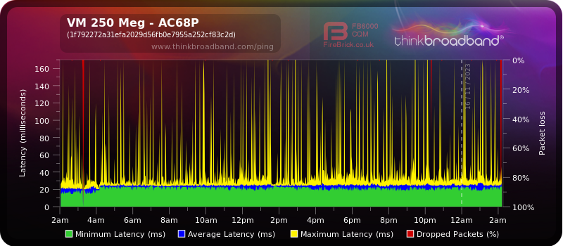

Over the past month or so I keep having connection issues, my Superhub was recently changed from a Superhub 2 (almost flawless) to a Superhub 5. Since this was changed my router also now reboots randomly which is annoying as it constantly keeps disconnecting me.
Could someone take a look at my levels / connection to see what the issue is being caused by, apparently there was an SNR fault which was resolved however I'm still having issues.

7 Replies
    That's a poor log and BQM.  Are you sure the SNR has been fixed? The interesting thing is I'm also getting those

      Apparently the ticket was closed and issue was resolved but I've been having more issues along with my SH5 now rebooting itself randomly since it was replaced.

        Thank you for posting your Hub stats and a dreadfully colourful BQM 😰 That does not look good!
        Another thing to check is the Service Status Page to see if there are any outages that could be causing issues at your address.
        You can also use our Faults Diagnostics Tool on your MyVM Account to find out why your service is rocky at the moment.
        For now though, I'd really like to take a closer look into your services to check everything over, so I'll send over a PM now 🙂
