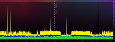

Thanks Steven for checking in and eventually getting through security checks for everyone else I am now back in router mode this morning and BQM looks like this -
- fizzFibre optic
and now for 24 hours +
