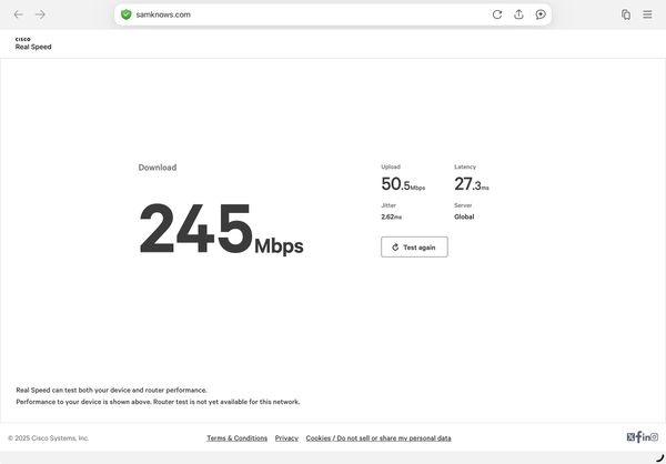

      It’s started dropping speed again - it was doing ok for a few days but last couple of days has dropped back to 245mb on WiFi. Wired still ok.
      Any other suggestions?

      No wired seems fine. But the wired connection is also coming from the Asus which appears to be getting 500mb.
      I have reset ASU’s this morning but still the same.
      So currently, vm hub in modem mode, hard wired to asus. In asus settings, speed test shows over 500mb:
      From the ASUs, the Apple TV, Denon, ps5 etc all hard wired. They get 500mb:
      I know about the wires - I’ve ordered some trunking…
      But WiFi connected devices are only getting 294mb
