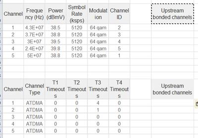

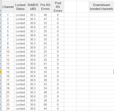

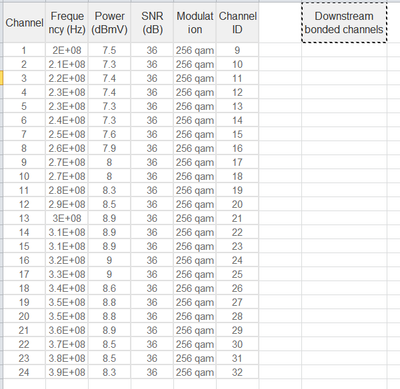

Are my downstream/upstream powers okay? I am experiencing high download/upload latency
Hi all, I've been facing issues with my wifi recently where my connection drops. The speeds are a little bit lower than expected sometimes, but the main issue is the intermittent wifi. Sometimes pages do not load, my connections drop, and I disconnecting from online games (other examples from games include an unstable ping). When I go to Speed Test, I can see that my idle latency is good, but my upload and download latencies spike and sometimes stay abnormally high (three digits).
I've called up VM and they've ran through the test of testing the download and upload speeds, which of course came back fine. Unsurprisingly, they said that nothing is wrong, as a result and that there's not much we can do apart from move closer to the router (I am a few meters away from the route in the next room), using ethernet, and factory resetting.
I'm considering getting a third-party router in hopes to fix it but I do remember that in a previous household I've lived in, I had my power levels checked. Are mine okay?
Thanks in advance!

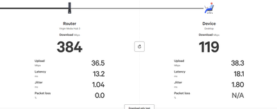

  • When I say they checked our speed, they got us to use an app/website on our phone and asked us to run that in each room in the flat. Does the app/website test power levels too?
    The Hub 3 Downstream power levels are on the high end but acceptable, errors are not a problems so at the moment the connection to the network looks to be OK.

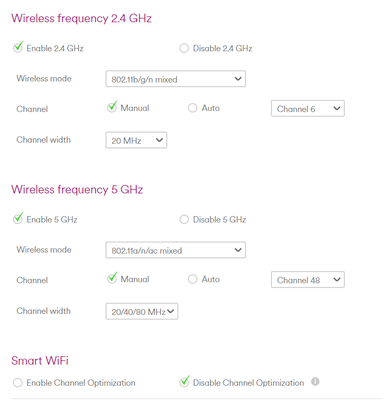

    We have a Hub 3 in Router mode. The Wi-Fi is very stable, but to get to this we have disabled Auto channels on both the 2.4 and 5 GHz band.   The Hub 3 stops / starts the Wi-Fi at random to perform the auto channel changes, as soon as this behaviour was prevented I can stream TV all evening over WI-Fi & not a single issue.
    Share some stats showing the latency to the Hub and the end devices..
    Once the test begins click on: Run full test to see all the stats.

      It seems okay on RealSpeed judging by the screenshot. I'll give the disabling of auto channels a try in the meantime.

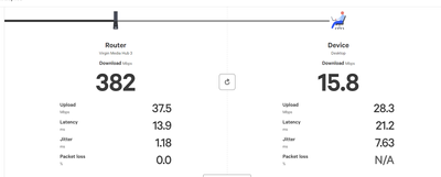

        I've tried changing it to manual (with the help of a wifi/channel analyser) and my speeds have been butchered:
        I will try some other channels and if it continues, I will switch back to auto
