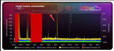

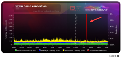

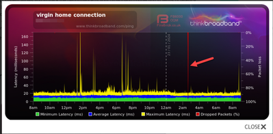

noticed the last couple of days my connection has got a bit unstable, with the red light flashing on the SH5.  Lose connection for a couple of mins then comes back.
Here is my BQM monitor for the last 24 hours

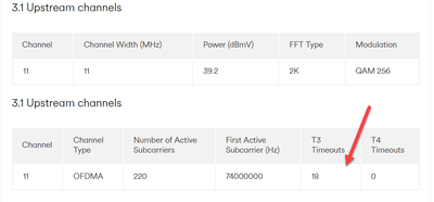

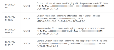

      I reset everything yesterday.  No reboot last night, but did get a load of T3 errors on one of the upstream channels.

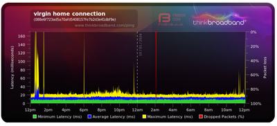

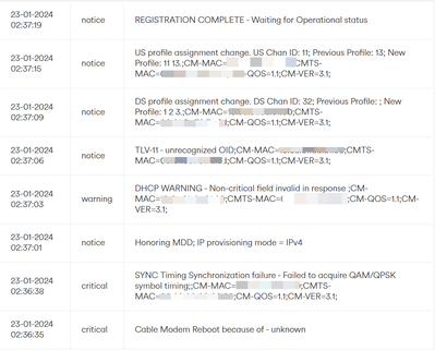

  • so after a few days without any reboots.  Last night the hub 5 rebooted again @ 2:36am.  Same issue "Reason Uknown".  If this is VM just doing some kind of maintenance, can you just let me know, and I wont bother trying to chase down the problem.

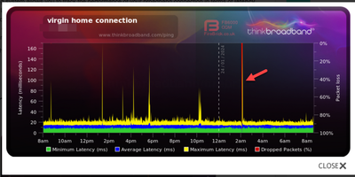

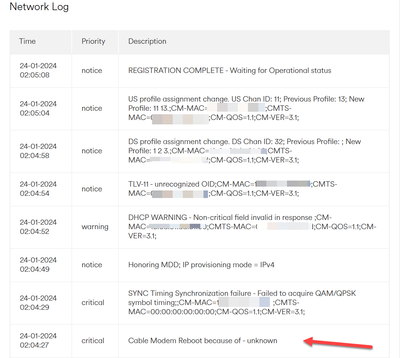

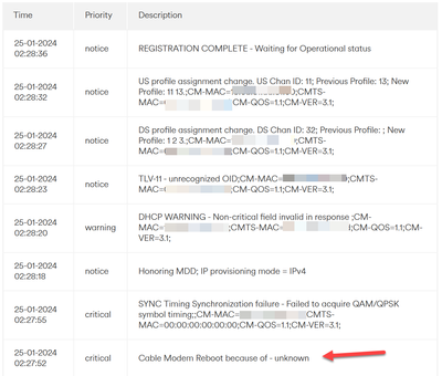

  • Re-boot again last night, that makes two days in a row, all around the same time.  Ive done a complete reset on all my kit again, yesterday, but no change.  Could it be a firmware update, that somehow is failing to run correctly, resulting in the hub 5 rebooting ?
    The main problem im getting is my house alarm is hooked up to the internet, and my provider keeps getting notifications that they have lost connection, so send me an alert
    I dont think this is a hardware fault, as this is the 2nd Hub 5 fitted, and both had the same issue.

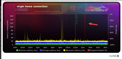

  • Reboot again last night, thats Three days on the trot.
    Has VM any idea whats causing them ?

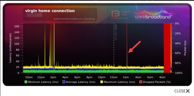

  • So here we are 6 weeks later.  I have had three engineers, two hub 5's and a hub 4, and still getting re-boots every Tues, Weds and Thurs Morning between 2:00am-2:50am.  The issue is my internet is tied to my security system, and they keep sending me alerts in the middle of the night saying my alarm system is offline.
    Not sure what to do next.
