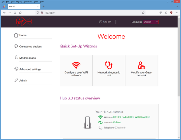

    The Hub admin menu at 192.168.0.1 is an HTTP address, it is normal for it to show as not secure.
    Tell you browser to proceed & ignore the warnings.   All will be absolutely fine.
    Below is a screen shot of our Hub 3 admin menu.   Note the padlock with a red strike through just to the left of the 192.168.0.1 URL .... it is not secure for everyone.
