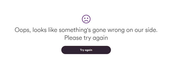

      Not able to double-check at the moment - this error seems to appear quite a lot. But I'm pretty sure it is activated cos websites were being blocked a few weeks ago, it's only fairly recently it's stopped blocking.

    Now I understand, the OP is faced with the VM Online Account not functioning,
    numerous customers have complained about this for over 3 years.
    It really is one of the most long standing defects that VM just do not fix.

      I just joined 2 weeks ago and I'm experiencing being unable to change settings
      • evemc's avatar
        evemc
        Yep, over 2 years I've been reporting these issues, not once has it been fixed.
