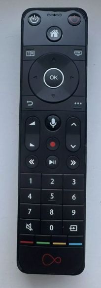

Hi all, some strange reason my volume control on my remote has stopped working. This is includes volume up/down and mute functions. I recently changed the batteries re-paired and still doesn’t work. When re-pair method is used via searching model of tv the volume buttons work. Soon as I come out of that page back to settings they do not work again.
I have tried a disconnecting power source from my virgin box and also left the batteries out of the remote & re-paired with the same outcome.
any one had similar problems? I have the long slim remote with account button on the side.
    Hi TidyB
    You've posted in the V6 forum, however I think you have a 360 box. The V6 remote control is peanut shaped.  The TV360 and Stream boxes have a slim, oblong shaped remote. They also have a voice button which  isn't available on the V6 boxes. There isn't an account button - Do you mean the Profile button on the side (looks like a head and shoulders)?  If so you have either a TV360 or Stream box. (See screenshot below)
    Please try the following.  Hold  down the 'Live TV' (the one on the right hand side directly below the red power/standby button) and '0' button together for around 10/15 seconds. The Standby button should then start to flash followed by an onscreen message displaying 'Pairing successful - this remote will only work with this Virgin 360 box'.
