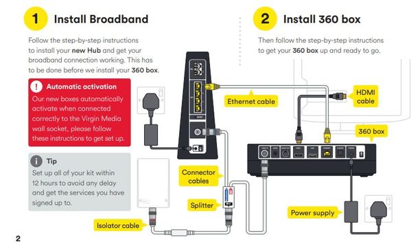

      Double check the upstairs coaxial cabling. It's possible that it's worked lose or hasn't been reconnected when you removed the hub from that location, or that the small cable adapter either hasn't been attached at both ends, or it's bent.
      Also since you removed the hub from upstairs the white coaxial should attach between the wall box and the splitter (unless you've removed the splitter), and then the smaller white cable adapter between the splitter and the V6.  (The pictures below apply to both the V6 and 360)
