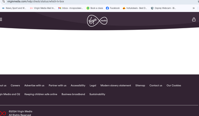

I tried running the service status check and it says ‘There are issues affecting your TV service’ It then displayed Follow our steps to check the TV box and get things fixed quickly and I click on the Get started button but I get a blank screen (see below), so that's no help either.

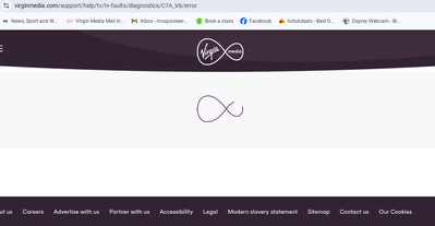

So I am trying to book an engineer visit and each screen tries to check service/equipment - It's now saying 'Sorry the box isn't connecting right now', clicked on  'Get started' followed instructions but eventually stuck with this screen
I can't seem to book an engineer appointment although I have tried various routes and keep coming up with checking services sequence and then the blank screen again. (I tried the 'Manage/change appointment' options but without an initial appointment booking, I keep going round in circles and get nowhere!
Clicking on other links I found a screen saying 'Our checks have detected an issue with this box: Smartcard provisioning issue' So I followed the instruction then it said it was running checks and requested reboot of hub. This I did and lost everything on the screen. Tried to get back in and saw a chat option p- Then I went through the chat process but after keying in short description as requested, the chat box disappeared.
