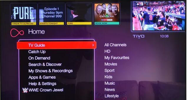

        Does the TV screen look like the picture below, or is the mini program picture in the bottom right corner?
        v6 epg
