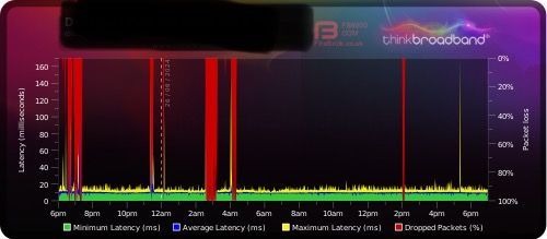

have a look at BQM - I’ve already stopped using the broadband for anything other than tv connection

      ironically the broadband is still showing red in sections always been the same if the circuit drops the tv eventually goes

    I only queried, because BQM's have limited diagnostic value in a TV issue unless complete loss of picture (with signal-related error codes) was coinciding with broadband drops. And quite a few users wrongly assume live TV uses the internet.
    Pixellation is usually a signal issue, but if it's coinciding with issues showing on your BQM, there's a good chance the problem is common & external. Just make sure you've rebooted the V6 once, to rule out a SW issue.

    I have looked further into this and can see that there is an issue with your downstream channels, the power levels are too high on some of the channels and you also have issues with missing upstream channels. We would need to send out an engineer to get this looked into further. I can arrange the appointment from here but would need to confirm a few details via a private message, that I will drop over in a moment. Please look out for the private message and we can get started.
