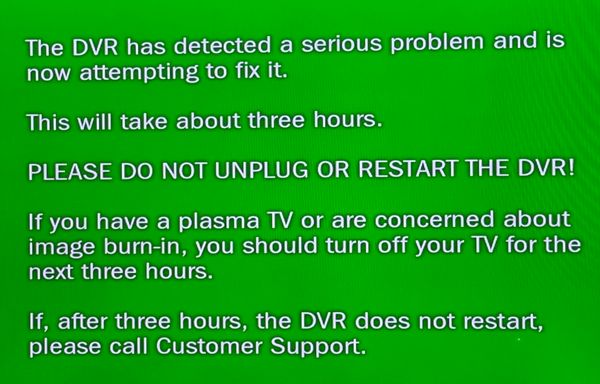

Green Screen of Death!
I turned on my V6 box yesterday morning, and it came up ok on the TV channel I was previously watching, then when I went to the Home screen and selected Apps & Games and tried to load My Favourite Apps, the machine appeared to switch itself off. Then I got the Welcome screen, to show it was trying to reboot, and then I got the dreaded Green Screen of Death…
Having read in this forum that a V6 box rarely recovers from this, I got on the phone to Virgin Media, but during the 20 minutes I was on hold, the box did successfully reboot. All my recordings were still there, and I have watched a couple since. The only thing missing was the channel logos on the TV guide, which wouldn’t switch on, so I did a standard reboot - unplug, wait 30 seconds, plug back in - later in the day, and the logos came back.
The box has been working fine ever since, but I have 2 questions…
  1. Given that the box successfully rebooted itself, is it likely that I have been lucky, or should I phone up and demand a new box - and will Virgin Media agree to install one, given that the current box is now working fine?
  2. I have so far held off from upgrading the software to 360, as I have recordings I still want to watch, but if I do go ahead and run the upgrade, will this fix the problem by reformatting the hard drive, or is the upgrade likely to crash part way through and leave the box unusable?

      • DaffyH3's avatar
        DaffyH3
        Thanks Matthew, the engineer came on Saturday and installed a new box for me. All is working fine so far. Thanks for sorting this out.
  • japitts's avatar
    japitts
    On your 2 points..
    1: The green screen is a strong indicator of HDD failure, you have been very lucky to at least restore some service but another subsequent failure is almost certainly a matter of time.
    2: It's almost irrelevant. Your box has a dying hard drive. Whether it's running TiVo-firmware (V6) or Horizon-firmware (TV360) is immaterial. If you want to convert to TV360, then you'd be very wise to request so with a new box. If you want to remain with V6, then you need a replacement box.
