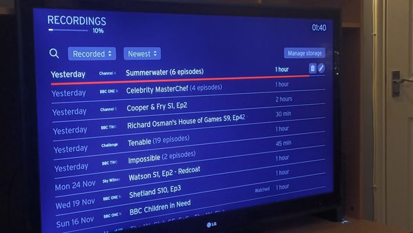

  • drickerby's avatar
    drickerby
    It's happened again - The box has lost the channel icons (see attached photo). I sense another forced hardware reset is coming.
    Please can I get some progress on a box swap for this?
