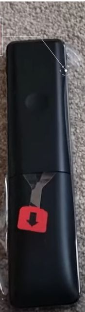

      Hi Nanny2-6
      There's a little plastic strip on the 360 remote (the battery tab) that you need to pull off so the batteries can power the new remote. See screenshot at the bottom.
      The 360 remote control should be able to be paired to the box by holding down the 'Live TV' button (the one on the right hand side directly below the red power/standby button) and the '0' button together for around 10/15 seconds. The Standby button should then start to flash followed by an onscreen message displaying 'Pairing successful - this remote will only work with this Virgin 360 box'.
      You can also try the following:-
      Put the box into 'Pairing Mode' by pressing the Standby/On button on the front of the 360 box for 10 seconds. Then using the remote control, press and hold the 'Live TV' button and the '0' button together for 10/15 seconds. And fingers crossed hopefully a message should appear on the screen confirming that pairing was successful.
