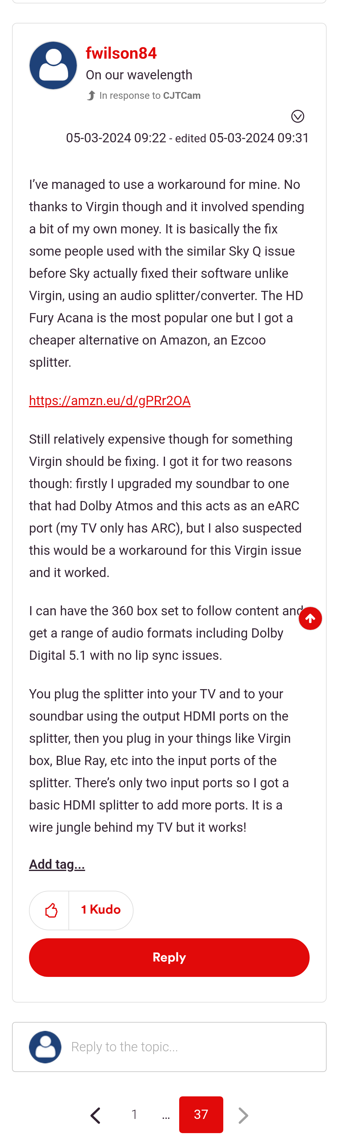

    Here's a fix that requires spending money, note this is after 37 pages and no solution .
