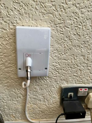

Firstly i think I need a female to female cable so i can connect from the TV 360 splitter where it says "Wall" to the "Virgin Media Wall Socket" on the wall.
If you see my picture of the wall socket and the label marked as "Wall " on the TV 360 Splitter Cable, how on an earth am i meant to connect from the splitter to the wall socket?

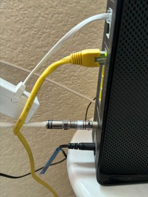

Secondly the broadband cable marked as blue on the Splitter cable is short for me in order to connect it to the Hub 3 Router.

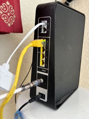

I think I need an extension cable "female to female screw in cable" because my Hub 3 router (see pictures below) has screw in connector if that make sense. I need to be able to connect from the broadband (blue label) from the TV360 Splitter cable to the Hub 3 Router. Does that make sense?

  • Virgin Media Wall Socket and how existing broadband cable is connected to it to the Hub 3 Router
  • Virgin Media Hub 3 Router and how the existing broadband cable is connected from the Wall Socket to the Router

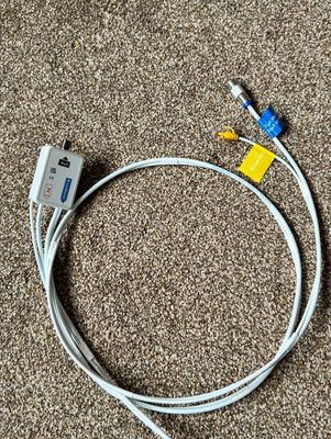

  • Splitter cable from the TV 360 Box I have received from Virgin today.
My issue is the TV 360 Splitter cables are "push-in / don't screw in" type but as you can see from my pictures, my current setup are all screwed in. The longer cables sent out to me have a label that says "don't screw in". So I am confused based on my current setup.

Broadband cable connected from wall outlet to Hub 3 RouterBroadband cable connected from wall outlet to Hub 3 RouterTV 360 Splitter CableVirgin Media Wall Outlet with Screw (Existing Setup)

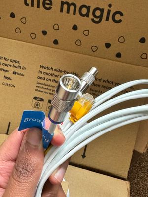

    Looks wrong, but cannot see the end of the second cable in picture 3.

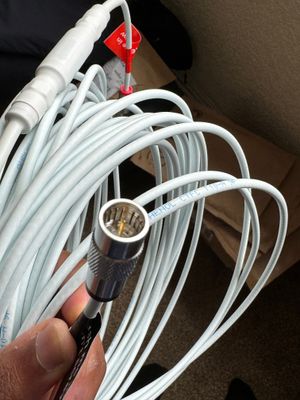

      Anyway please see below regarding the picture of the cables and type of connectors on each end.
      1. 10m cable VM sent me which shows the Wall outlet (Red) end and the Broadband end (Black)
      2. The TV360 Splitter cable - Broadband connector end (Blue)
      Can you advise? How do i get attention of a Virgin Media representative on this forum?
      10M cable - Wall Outlet connector end(Red)10 M cable - Broadband connector end (Black)TV 360 Splitter Cable - Broadband connector end (Blue)
